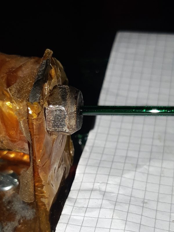

printing with pet bottle filament like with pla up to 100-120mm/s ,forget slow print anymore , you need to little upgrade to your machine what you need
:Изображение
( all metal hotend micro swiss clone with heatblock fixation screews like on picture ,not the original micro swiss)
and Compression Stainless Steel Pipe Fittings
Изображение you got for 4mm
enjoy
