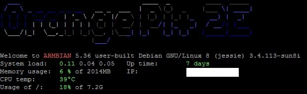

armbianmonitor -r

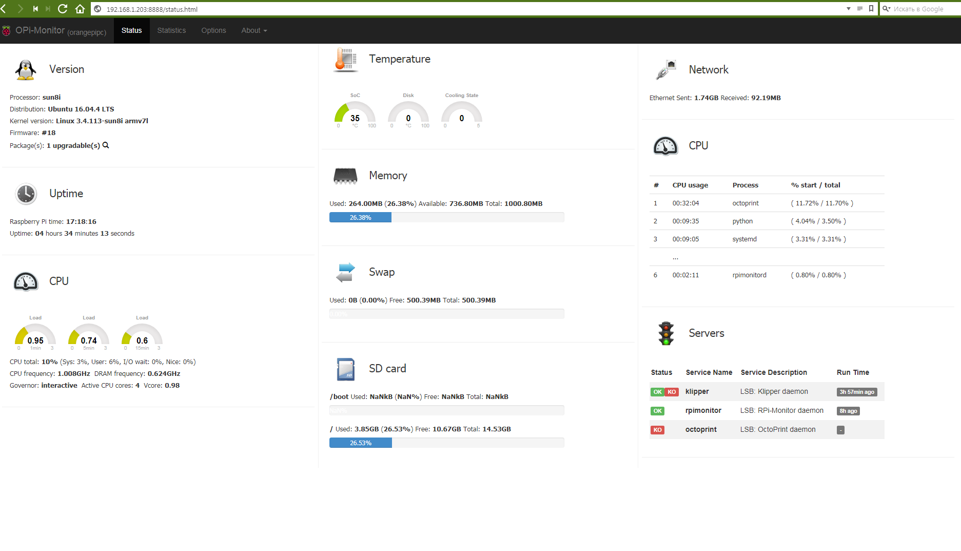

Ставится такая вебморда
Вот только использованную память некорректно считает.
аддон показывающий сервисы
# Extract information about Services
dynamic.1.name=klipper_desc
dynamic.1.source=service klipper status | grep "klipper.service - "
dynamic.1.regexp=- (.*)
dynamic.2.name=klipper_act
dynamic.2.source=service klipper status | grep "Active: "
dynamic.2.regexp=(\(.*\))
dynamic.3.name=klipper_runtime
dynamic.3.source=service klipper status | grep "Active: "
dynamic.3.regexp=; (.*)
dynamic.4.name=rpimonitor_desc
dynamic.4.source=service rpimonitor status | grep "rpimonitor.service -"
dynamic.4.regexp=- (.*)
dynamic.5.name=rpimonitor_act
dynamic.5.source=service rpimonitor status | grep "Active: "
dynamic.5.regexp=(\(.*\))
dynamic.6.name=rpimonitor_runtime
dynamic.6.source=service rpimonitor status | grep "Active: "
dynamic.6.regexp=; (.*)
dynamic.7.name=octoprint_desc
dynamic.7.source=service octoprint status | grep "octoprint.service - "
dynamic.7.regexp=- (.*)
dynamic.8.name=octoprint_act
dynamic.8.source=service octoprint status | grep "Active: "
dynamic.8.regexp=(\(.*\))
dynamic.9.name=octoprint_runtime
dynamic.9.source=service octoprint status | grep "Active: "
dynamic.9.regexp=; (.*)
web.status.1.content.1.title="Services"
web.status.1.content.1.line.1="<style type=\"text/css\">.tg331 {border-collapse:collapse;border-spacing:0;}.tg331 tr:nth-child(even){background-color: #f2f2f2}.tg331 table{border: 0px solid #e9e9e9;}.tg331 td{font-family:Arial, sans-serif;font-size:14px;padding:12px 2px;border-style:solid;border-width:0px;overflow:hidden;word-break:normal;}.tg331 th{font-family:Arial, sans-serif;font-size:14px;font-weight:normal;padding:12px 2px;border-style:solid;border-width:0px;overflow:hidden;word-break:normal;}.tg331 .tg331-yw4l{vertical-align:top;text-align: left;}.tg331 hr {display: block;margin-top: 0.5em;margin-bottom: 0.5em;margin-left: auto;margin-right: auto;border-style: inset; border-width: 1px;}</style><table width=\"100%\" class=\"tg331\"><tr><td><b>Status</b></td><td><b>Service Name</b></td><td><b>Service Description</b></td><td><b>Run Time</b></td></tr><tr><td>"+Label(data.klipper_act,"=='(running)'","OK","success")+Label(data.kodi_act,"!='(running)'","KO","danger")+"</td><td><b>klipper</b></td><td>" + data.klipper_desc + "</td><td>"+Label(data.klipper_act,"=='(running)'",data.klipper_runtime,"default")+Label(data.klipper_act,"!='(running)'","-","default")+"</td></tr><tr><td>"+Label(data.rpimonitor_act,"=='(running)'","OK","success")+Label(data.rpimonitor_act,"!='(running)'","KO","danger")+"</td><td><b>rpimonitor</b></td><td>" + data.rpimonitor_desc + "</td><td>"+Label(data.rpimonitor_act,"=='(running)'",data.rpimonitor_runtime,"default")+Label(data.rpimonitor_act,"!='(running)'","-","default")+"</td></tr><tr><td>"+Label(data.octoprint_act,"=='(running)'","OK","success")+Label(data.octoprint_act,"!='(running)'","KO","danger")+"</td><td><b>octoprint</b></td><td>" + data.octoprint_desc + "</td><td>"+Label(data.octoprint_act,"=='(running)'",data.octoprint_runtime,"default")+Label(data.octoprint_act,"!='(running)'","-","default")+"</td></tr></table>"
