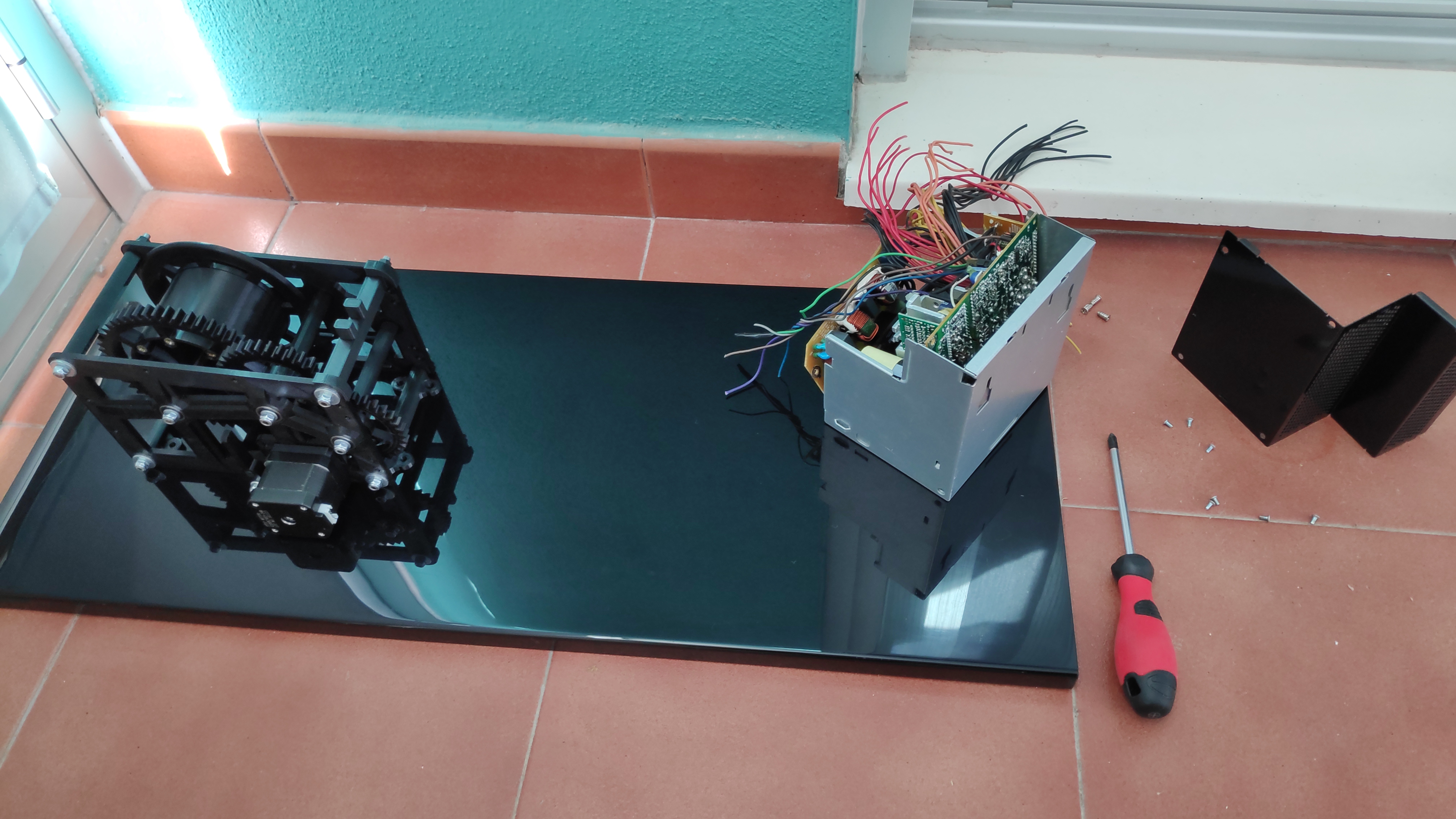

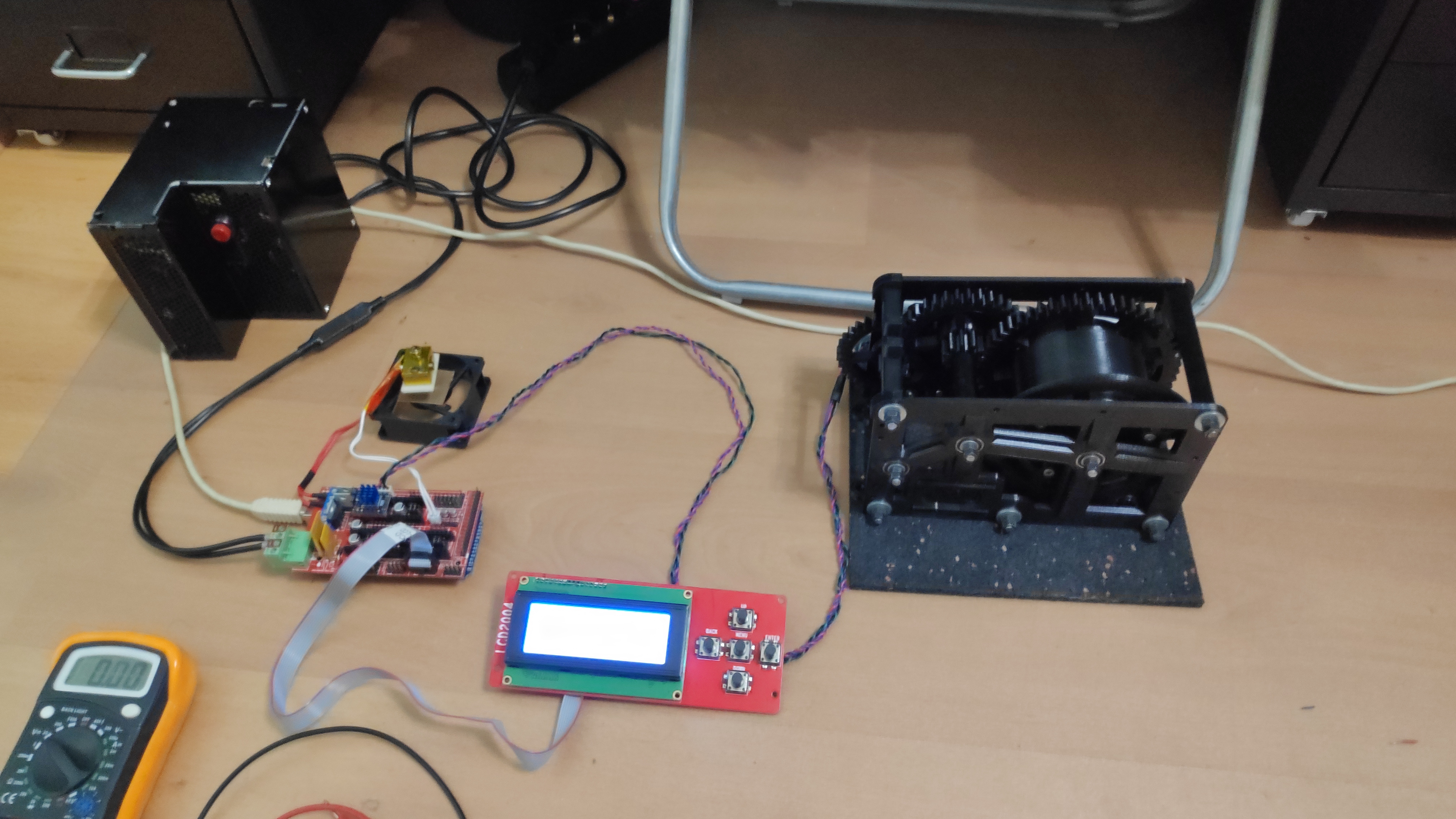

Здравствуйте, я испанец и использую переводчик Google. Я занимаюсь изготовлением этого проекта. Какое значение (stepper) я должен поставить (Marlin) для редукции 98 (Petpool-2.1)? stepper value in marlin for reductive 98 Petpool-2.1?

I had change the gears at petpul V2.1 for my self, it is supporting koef.of reduction the 98. Marlin has stepper motor driver reduction too. But the nominal base reduction must be set 1/16 at driver board A4988 level via 3 jumpers on the borad. To find out Marlin FW reduction number you must pass test to equil the speed if you are using g-code. The max speed of process is about 2,5mm/sec

This divider you must find via tests of filament speed, Probably more or less true is 101 instead of 80 from start of tests. The owner of project not using the marlin, he has developed the special board with special FW, so, if you are in g-code and Marlin, you should find divider yourself.

I use my A8's board to power the petpull's stepper and I'm quite fine with the default 100,100,400,100. The stepper doesn't react to numbers higher than 3000 and I usually set it to 1500

Установите значение 2500 steps/mm для фактического продвижения 2 mm/s . g-code ( F120 = 2mm/s )
Nema 17, 1.8º, TMC2208, microsteps 1/16

you have to configure DEFAULT_AXIS_STEPS_PER_UNIT so that mm/s is correct, my configuration marlin is #define DEFAULT_AXIS_STEPS_PER_UNIT {1500, 1500, 1500, 1500}
For my configuration (F120 = 120mm/min = 2mm/s), for your configuration (F1200 = 1200mm/min = 20mm/s). What STEPS values ​​do you have configured in marlin?

So, it comes out that it's either 1500 steps per mm in the firmware and F120 in the command or 100 steps in the firmware and, say, F1500 in the command. The same output about the rotation speed but at least I don't have to flash the board every time when I decide to pull filament. As I have said I use the same board both for printing and pulling so flashing it back and forth would be kind of tiresome )
